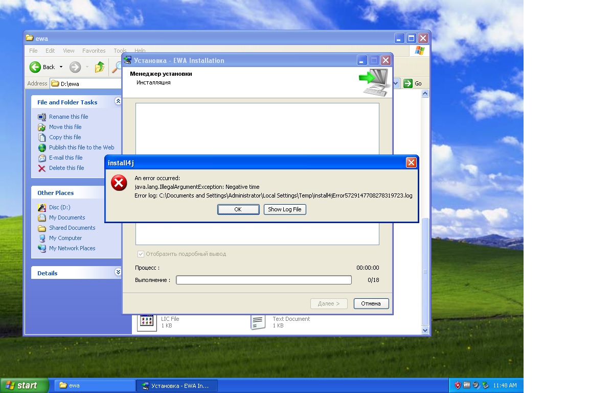

Добрый день! в общем поставил vmware, там создал виртуалку win xp professional. запускаю установку ewa и вот такая проблема:
А в log-файле что?
вот:
Exception:
java.lang.IllegalArgumentException: Negative time
at java.io.File.setLastModified(Unknown Source)
at com.install4j.runtime.beans.actions.files.CopyFileAction.executeForSingleRecursiveFile(Unknown Source)
at com.install4j.runtime.beans.actions.files.AbstractRecursiveFileAction.executeForSingleFile(Unknown Source)
at com.install4j.runtime.beans.actions.files.AbstractFileAction.executeForMultipleFilesAction(Unknown Source)
at com.install4j.runtime.beans.actions.files.AbstractRecursiveFileAction.executeForMultipleFilesAction(Unknown Source)
at com.install4j.runtime.beans.actions.files.CopyFileAction.executeForMultipleFilesAction(Unknown Source)
at com.install4j.runtime.beans.actions.files.AbstractFileAction.execute(Unknown Source)
at com.install4j.runtime.beans.actions.SystemInstallOrUninstallAction.install(Unknown Source)
at com.install4j.runtime.installer.InstallerContextImpl$2.fetchValue(Unknown Source)
at com.install4j.runtime.installer.helper.comm.actions.FetchObjectAction.execute(Unknown Source)
at com.install4j.runtime.installer.helper.comm.HelperCommunication.executeActionDirect(Unknown Source)
at com.install4j.runtime.installer.helper.comm.HelperCommunication.executeActionInt(Unknown Source)
at com.install4j.runtime.installer.helper.comm.HelperCommunication.executeActionChecked(Unknown Source)
at com.install4j.runtime.installer.helper.comm.HelperCommunication.fetchObjectChecked(Unknown Source)
at com.install4j.runtime.installer.InstallerContextImpl.performActionIntStatic(Unknown Source)
at com.install4j.runtime.installer.InstallerContextImpl.performActionInt(Unknown Source)
at com.install4j.runtime.installer.ContextImpl.performAction(Unknown Source)
at com.install4j.runtime.installer.controller.Controller.executeActions(Unknown Source)
at com.install4j.runtime.installer.controller.Controller.handleCommand(Unknown Source)
at com.install4j.runtime.installer.controller.Controller.start(Unknown Source)
at com.install4j.runtime.installer.Installer.runInProcess(Unknown Source)
at com.install4j.runtime.installer.Installer.main(Unknown Source)
at sun.reflect.NativeMethodAccessorImpl.invoke0(Native Method)
at sun.reflect.NativeMethodAccessorImpl.invoke(Unknown Source)
at sun.reflect.DelegatingMethodAccessorImpl.invoke(Unknown Source)
at java.lang.reflect.Method.invoke(Unknown Source)
at com.exe4j.runtime.LauncherEngine.launch(Unknown Source)
at com.exe4j.runtime.WinLauncher.main(Unknown Source)
at com.install4j.runtime.launcher.WinLauncher.main(Unknown Source)
